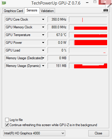

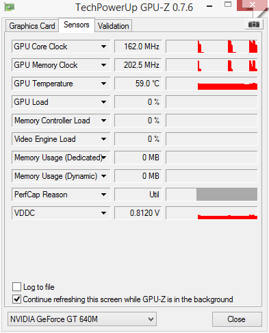

The graphics settings are the same for both. Here's what both the graphics cards look like while I'm not playing anything:
http://gpuz.techpowerup.com/14/05/06/2bz.png
http://gpuz.techpowerup.com/14/05/06/d69.png
And when I'm playing (I switched cards each time before taking screenshots):
I'm not really sure what to make of the numbers though. Also the laptop is a bit over a year old and I don't think it's had dust cleaned out of it before. Would I need to take it apart or anything to do that?
Also the framerate tends to be better on the integrated one, but also less stable. It still runs better despite that though.
Nothing looks particularly out of the ordinary. The GT 640M should run at 625Mhz for the core.
