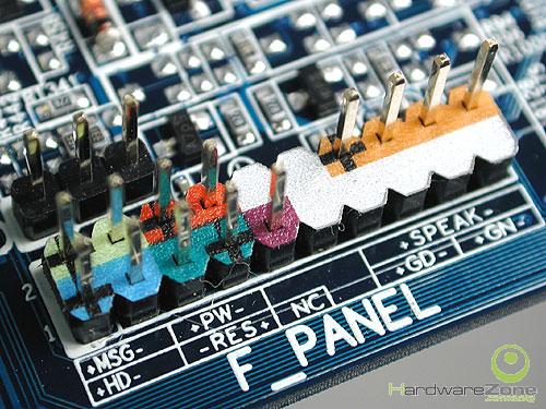

Are you sure power switch is connected to correct pins on motherboard ?
If it is then bridging pins with tip of screwdriver will turn pc on
If you have reset putton try connecting to power on pins
If case power switch faulty you have choice of swapping with reset switch, a new switch or new case
Fortunately your board has a power switch

Sounds like the your case's Front Panel wire is loose or inserted wrong.
If you look at reviews of the Be-Quiet Silent Base 800 case this is a known problem. I found this post talking about checking the contacts in the power switch connector:
"Had an issue with my power switch not working. One of the metal contacts in the plastic connector on the power switch wire was not seated completely. This resulted in much frustration as i though I was screwing up the motherboard pins. The connector is located under the top of the case."
