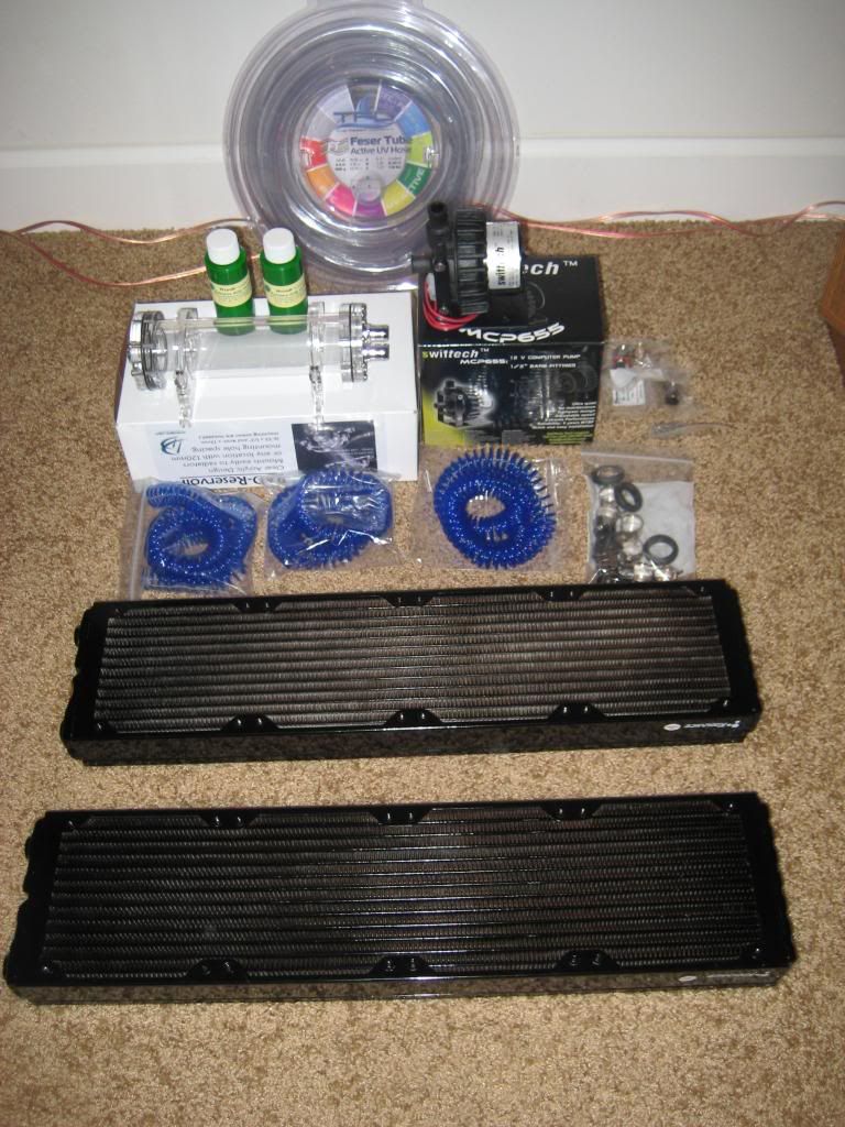

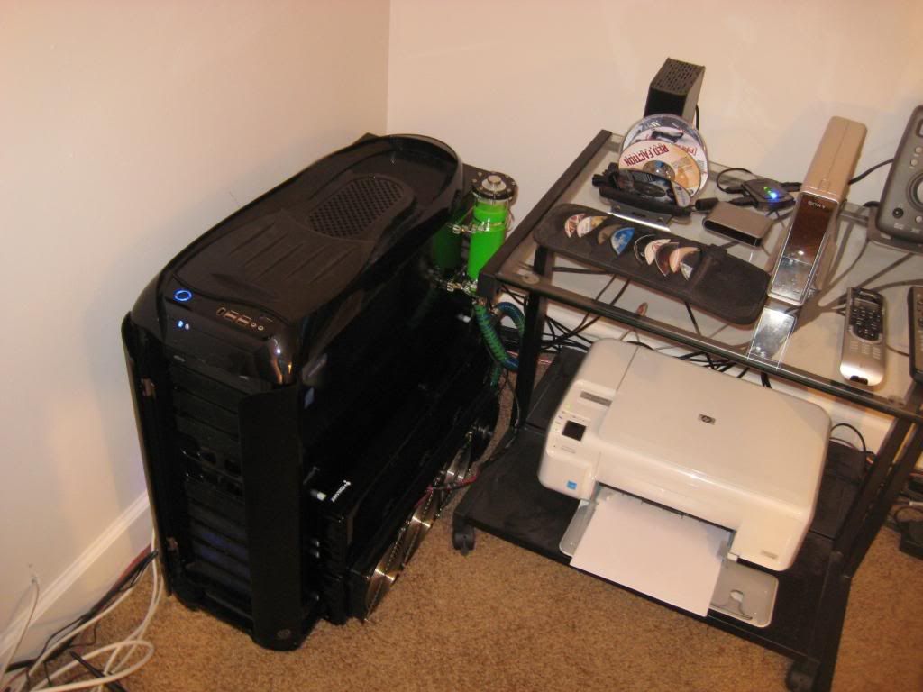

My setup- my first water cooling build

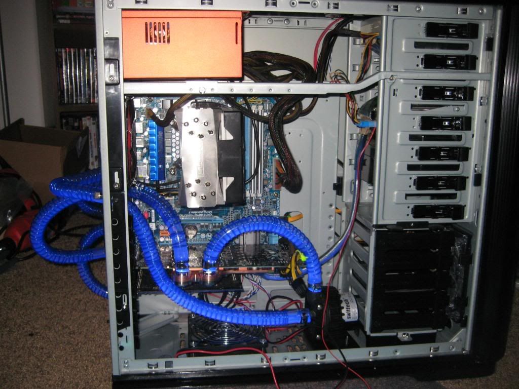

why dont you include your cpu in that loop? with those two radiators you have the cooling power to cool 2 whole computers =P

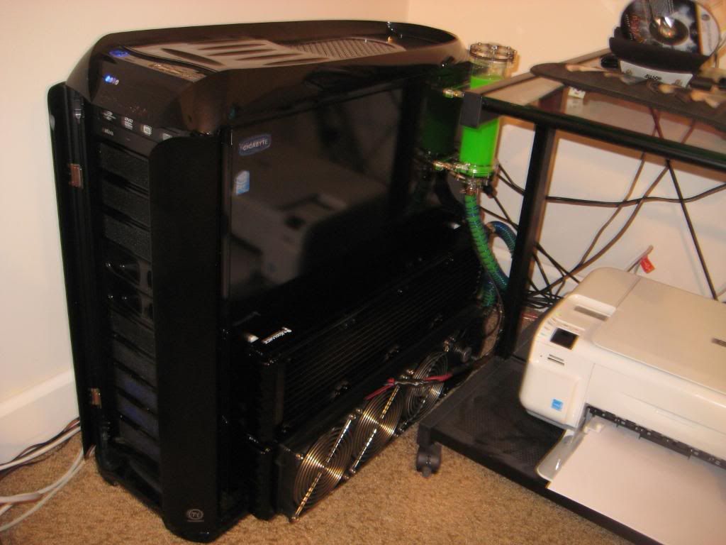

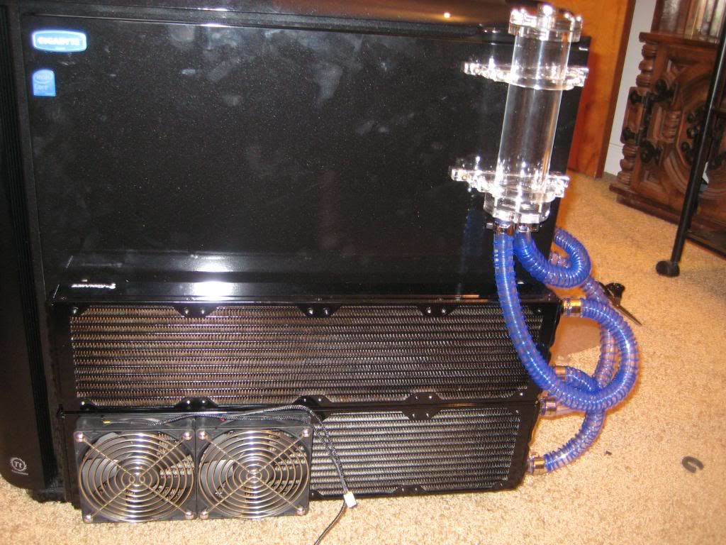

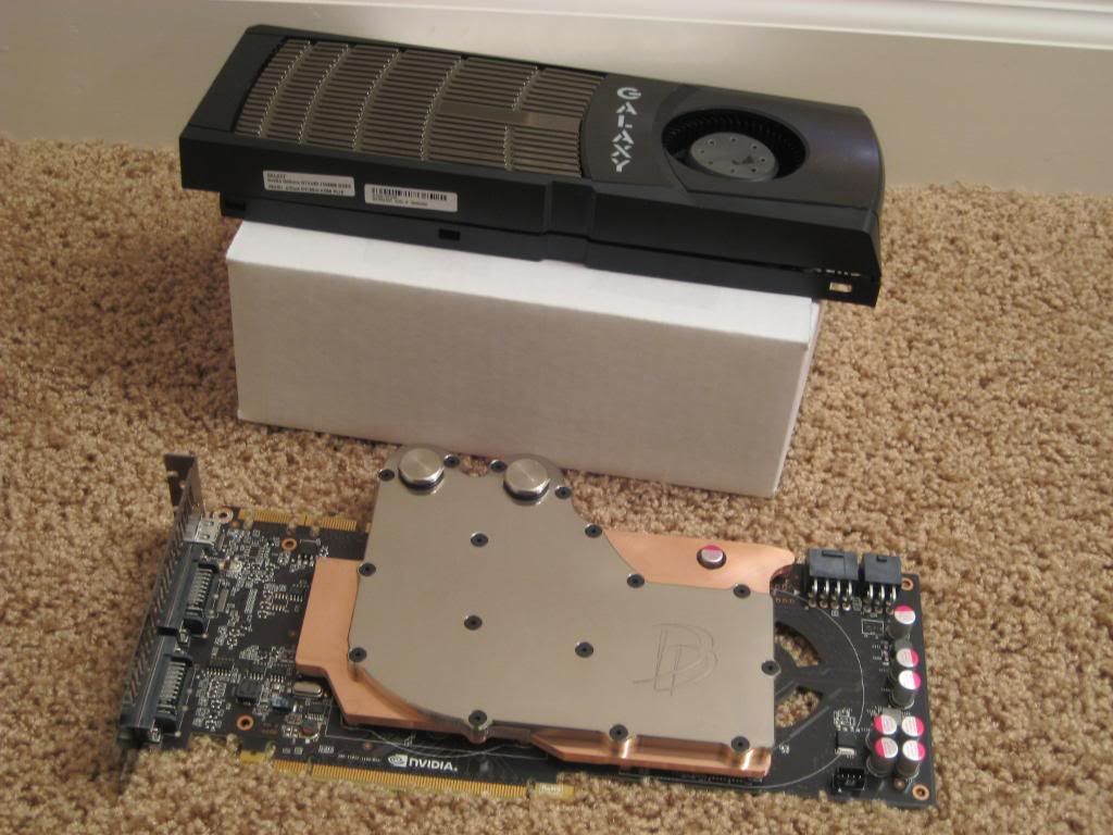

1. yes it's a galaxy gtx 480 with a danger den water block
2. I am planning on adding the cpu loop when I go sli, just not enough money yet
3. The radiators are actually have 1/2" nylon spacers, so there is plenty of room for the air to escape out the back.

I'd double the spacers. You will restict airflow.
Edit
Let me quantify my comment.
You will restrict air flow. How much? A decent amount. It depends on the fans and the way your loop cools. I think you'll be okay since your overradding. If your not happy with the temps try adding spacers instead of increasing fannage to keep it cool.
dreamphantom_1977
Jan 19, 2008
321
18,790
Well, I did a little test to see if my fans were affecting my cooling. I figured if they were being restricted then they wouldn't be doing there job well. In my original post (link above) I tested my cooling with msi Kombuster and it took almost half an hour to get to 55C which was the max it would hit. So what I did was I unplugged my fans to see how fast it would take to get to 55C. I thought if they aren't doing there job and are restricted, then the computer should take about the same time to get to 55C, or close too it. Well, it took 2 min to get to 55C. I timed it. And it hit 56C (above max) right after the 2 min mark. So I stopped testing and plugged the fans back in.
In just over 2 minutes my system without the fans got hotter then 1/2 hour with the fans. I could have tested more to see what the max would be, but my pump is rated at 60C and I didn't want to push it.
And just so everyone knows, kombuster extreme burn in really pushes your system to the max, not like playing a game. Your pushing your system 100% the whole time. Playing crysis for 1/2 hour gave me a max of 44C with my fans on.
So I assure everyone that 1/2" is enough space because the fans are doing there job. I got to thinking about it before I decided on the 1/2" inch spacers, I was gonna go with 1", but then I thought about the tri-sli setups a lot of people are running, and a lot of people run the cards practically touching and only like a couple of millimeters apart. How can the cards not over heat with such little space? Besides, I don't want the radiators sticking out so far. It's already leaning about 1/2" on the radiator side when it's on the carpet. LOL. :D

You got two 120x4 rads and only 4 fans? The second rad is like a 120x1 rad for cooling, you gotta get more fans.
58C is nothing to sneeze at, thats Very very good. My two GTX 280s and one 120x3 rad top out at 70F ambient over 50C. Your temps are great!
Anytime a hot loaded GPU is under 60C (IMHO) and quiet, the watercooling is working just fine.
Aha, I see, I read deeper. Yep my cards do the same. They warm up very quickly but then stay nice and cool. What you have gained is 3 monster GPUs that pull a TON of heat and you don't have to have the loud fans screaming on them. Besides load temps under 60C, your carfds will overclock better due to a cooler GPU chip.
Your temps won't stay low like you think they will. Thats not what normally happens in watercooling.
