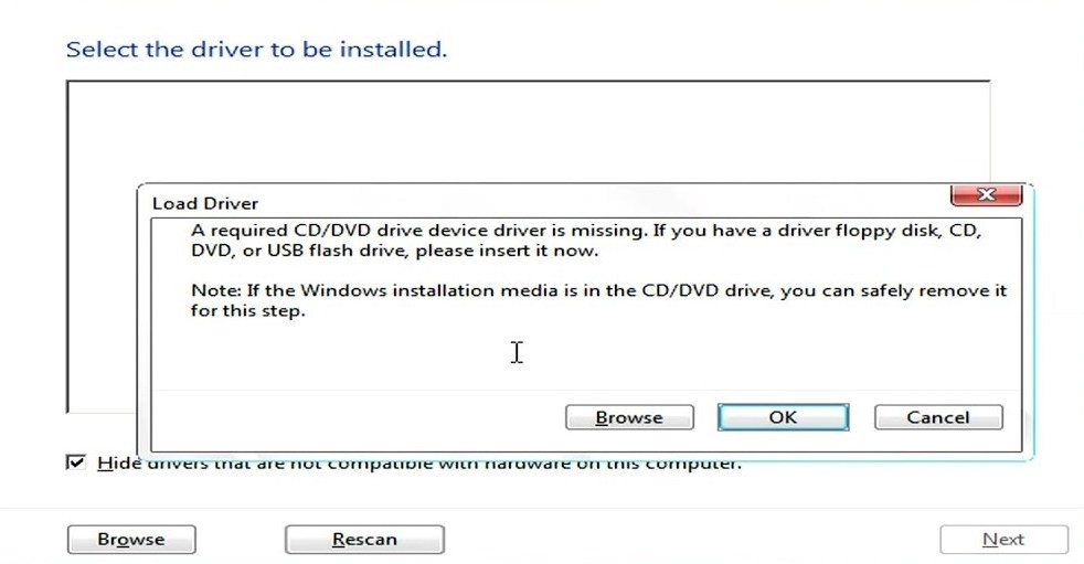

But the installation demands drivers. Which took me by surprise.
No drivers in sight.
Going to the CD that came with my lovely new Aorus Z370 board, and what I see is "Run.exe" that should be executed from inside the OS, which would check the board and install the appropriate drivers.
BTW there's no CD or floppy in this box. There shouldn't be any call for this type of driver.
So ... catch 22?
Win7 won't install w/o drivers, and mobo utility runs only under Windows.
What am I missing?
How to proceed? maybe some way to copy drivers from the CD (I haven't found them) to USB and point Win7 Installation at those?

My bootable USB from ISO launches fine. But the installation demands drivers. Which took me by surprise. No drivers in sight.
What am I missing? How to proceed? maybe some way to copy drivers from the CD (I haven't found them) to USB and point Win7 Installation at those?

Everything I find by searching ... related to drivers needed with fresh install of Win7 ... everything assumes that the OS is up and running.
It seems Win7 install is looking only for something very basic.
How to figure out what it's calling for?
Is someone familiar with this "failure mode"?

... extract the drivers from the container, then place them on to a USB stick ...
I'm looking at the folder for GBytes' WindowsImageTool and there are many subfolders. Many. Would all of those an a USB do the trick? will Win7 install know to sort through all of those to find what's needed? Because I don't know which is/are missing; I can't tell which one/s it's calling for.
BTW I've never encountered "container" in this context. What are you refering to?
I have the folders from GByte (above), I have the installation files on the USB, and I have the ISO ... where in that is the container?
p.s. I don't get it: Install needs an updated Driver to read the USB, but the installation files that are running came from that USB!

Might the missing driver be one from this directory? WindowsImageTool\USB\IntelUSB30\Drivers\Win7\x64 \
Probably not ... NVME drivers also needed. (Or maybe that's what's missing since that's what I have as boot disk.)
So, couldn't I just copy all the folders from the GByte utility folder?
You could try that. I don't remember offhand if it will look into the subfolders. So if that doesn't work, try putting all the drivers in the same folder.

I really would rather Win7-64. Is why I'm persisting with this.
Paradigmatic: we can't look under the hood to see where Install is looking for drivers, or how it is looking.
So yaaaa, good old fashion shotgun method coming up!

Windows 7 does not have Drivers for the usb3 used on modern motherboards.
Some motherboards may have a bypass or special usb.
A usb connected cd drive will not work.
A easy solution is to temporarily install a sata connected dvd drive and use that to install.
Otherwise, there is a more complicated slipstream method to merge needed drivers into the install stream.

SkyNet - I'm quite sure it's the VNME drivers (absence of) that the installation is choking on.
1. Integrate USB,vnme drivers with Gigabyte windows USB installation tool
I see that this version is for my board specifically, so thanks for that.
BUT I've tried WindowsImageTool 4 times and 4 times it has failed to patch the files.

1. Integrate USB,vnme drivers into USB windows installation with Gigabyte windows USB installation tool for your motherboard chipset (Z370)
https://www.gigabyte.com/Support/Utility?kw=windows&p=1
SkyNet - Using the precisely correct version of the utility (windowsimagetool_z370) I got the same failure as the previous 4 tries, viz.:
BTW in case you're thinking the USB was too small (I thought that might be the case) same thing happened with a 16Gig stick.
bentremblay
Jan 2, 2012
137
18,680
Done.
Perhaps because I had manually copied the NVME drivers to the stick, perhaps because it installed Win7 over Win10 (which I found kinda funny!) ... I can't say for sure.
