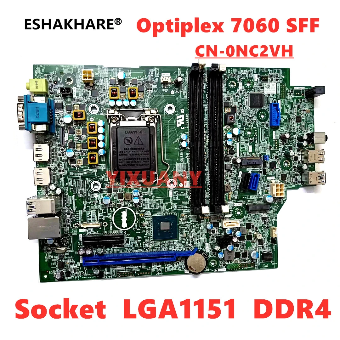

Question Need to figure out if my Dell Optiplex 7060 SFF has wifi card slot

I've not completely disassembled my Dell Optiplex 7060 SFF PC. I'm trying to determine if it has a slot for the wifi card. Here is a picture where I think it might be, below the blue drive outlet that is slanted...
After more searching I found this on the Dell website and it appears that must be the m2 slot for the wifi card. Page 14 https://dl.dell.com/topicspdf/optiplex-7060-desktop_specifications2_en-us.pdf
according to dell the board should have the following M.2 Connectors, so yes it should have a connector for a wifi card.
1 - 2230/2280
1 - 2230 (keyed to support Integrated or Discrete WiFi,
Support Intel CNVi or USB2.0/PCIe)
Quite frankly i would call up dell and give them your S/N number off the sticker on the case and order a wifi card from them for the computer. The newer SFF computers when they come with WiFi have a little black antenna that mounts to the back of the case.
1 - 2230/2280
