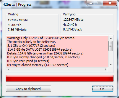

If I have any doubts as to the legitimacy of any newly acquired Compact Flash, Secure Digital or microSD cards, plus SSDs and USB memory sticks, I run a program called h2tesw.exe.
https://h2testw.org/
H2testw writes multiple 1GB files to the drive until it is full, then reads back the 1GB files and verifies the health and true capacity of the drive.
If you see results like this, everything is OK.
N.B. Don't worry about h2testw failing to test the final Megabyte of disk space.
If you see results like this, the drive is damaged and/or fake.
