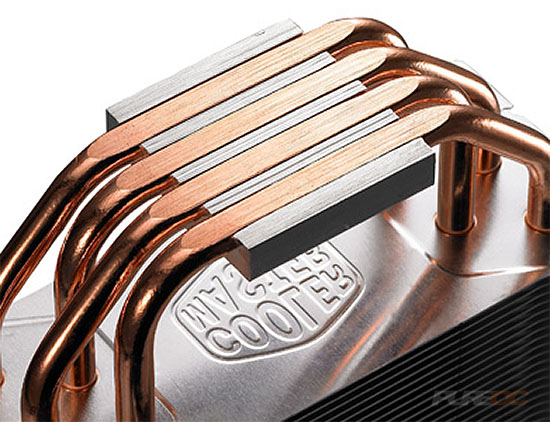

Thank you for the answers. Sorry for late reply. Couldn't come out due to fever. I tried my local markets for corsair vengeance but couldn't find them under budget. so ADATA is the final contender. Processor has been changed to 6700k thanks to lack of windows 7 support on kabylake. All is set except for cpu cooler. is there any performance difference between below two coolers? please tell me why? Do the gap between copper pipes reduces any cooling efficiency or can i buy the turbo model which has two pwm fans.
Cooler Master 212 LED & Turbo
Cooler Master 212 EVO
the Links for all three coolers.
CM212 LED Red :
CM 212 LED Turbo :
And CM 212 EVO
almost forgot : CM Hyper 212x
Yes, there is a difference. Unless you are overclocking the difference is not that significant. The 212 EVO is a better cooler though.
I don't think you actually need one that capable for the type of system you are going to be running this in though. A stock Intel cooler for an i7-6700 would work fine.
In reality, this is a better cooler than any of those, and is less expensive.
https://www.amazon.in/Deepcool-GAMMAXX-400-Universal-Cooler/dp/B007JEMXYQ/ref=sr_1_1?ie=UTF8&qid=1517180803&sr=8-1&keywords=deepcool+gammaxx+400
