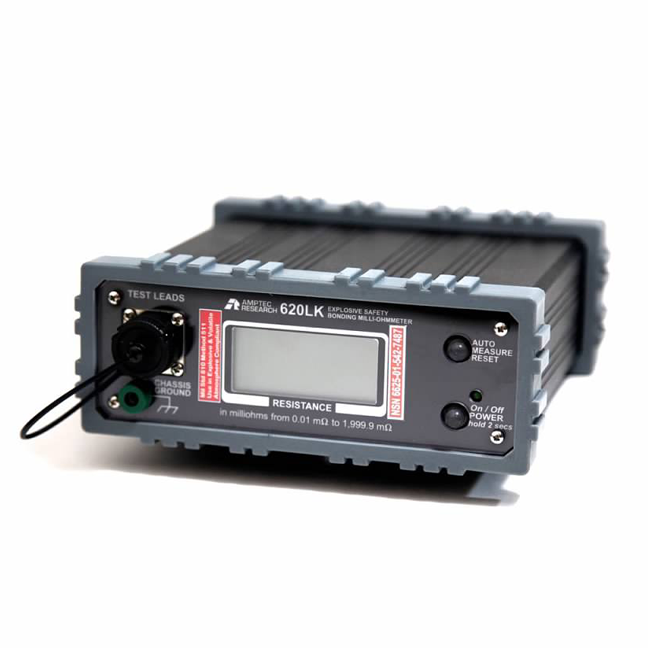

To check continuity between all metal parts, I'd use a professional bonding tester capable of measuring down to milliOhms. Failing that you could try using a multimeter, but this will be less effective.
https://www.amptec.com/products/bonding-testing/620lk/

The milliOhmeter I mentioned is intended to prove you've bonded all metal parts in a system to the safety earth connection. In a 19in rack system, this bonding is often achieved by separate safety earth wires or copper braid straps from rack to equipment. Hence, if a main earth fails, the equipment is still separately earthed.
