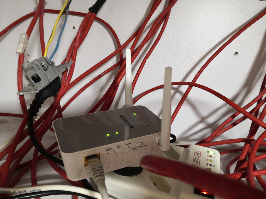

Or this one , a wifi repeater i'm using as an access point to give my father in the basement , internet access .
