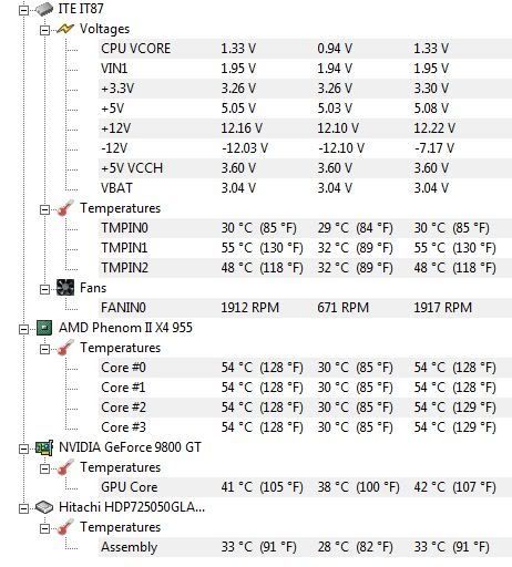

I get this while running a prime95 heat test: http://img.photobucket.com/albums/v98/Arokh/temps.jpg
How would I be able to monitor hwmonitor while running a fullscreen app?

All of those temps look fine, if that's under load. I think you're looking at a power supply problem.
And the amount of paste you applied to your cpu was perfect. No need to manually spread it.
