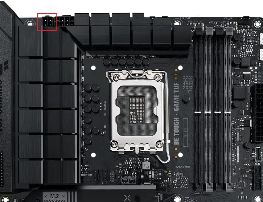

I just upgraded my motherboard and CPU to a TUF Gaming B760-PLUS and an Intel Core i5-14600KF. My PSU is a Corsair RMx Series RM650x 80 PLUS Gold.
I connected everything, but the motherboard won't boot. LEDs light up, fans are spinning, but nothing else happens. No beeps either.
I noticed the motherboard has an extra 4-pin CPU power connector, but I don't have a cable for it.
Could this be the issue? I’ve searched online and found conflicting answers: some say it’s optional, others say it’s needed. If it is required, would an adapter work?

This is all I get from documentation about those connectors:
Now, care to explain what are they for and if not connecting them might be the cause of the problem?

The extra 4 pin eps connector is normally not necessary.
It is there to give added power for multiple graphics cards and overclocking.
The 8 pin eps connector is likely necessary.

Ok, located the status leds and none lights up. Must I assume it is a faulty motherboard?

Well, the fact I can't get any of the status leds on, no matter what I try, leads me to think it must be a faulty motherboard. I'll reimburse it an order a new one.

The 4 pin is needed if you plan to overclock your processor which would need more power. To be safe, if your PSU has a 8 pin and an 4 Pin CPU Power connected I see no harm in connecting both.
