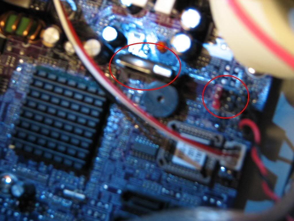

You can try resetting the CMOS, sounds bad however. (Should be a clear CMOS jumper on the MB near the 2032 battery, short (close) it for a few seconds with the PSU off/unplugged.)

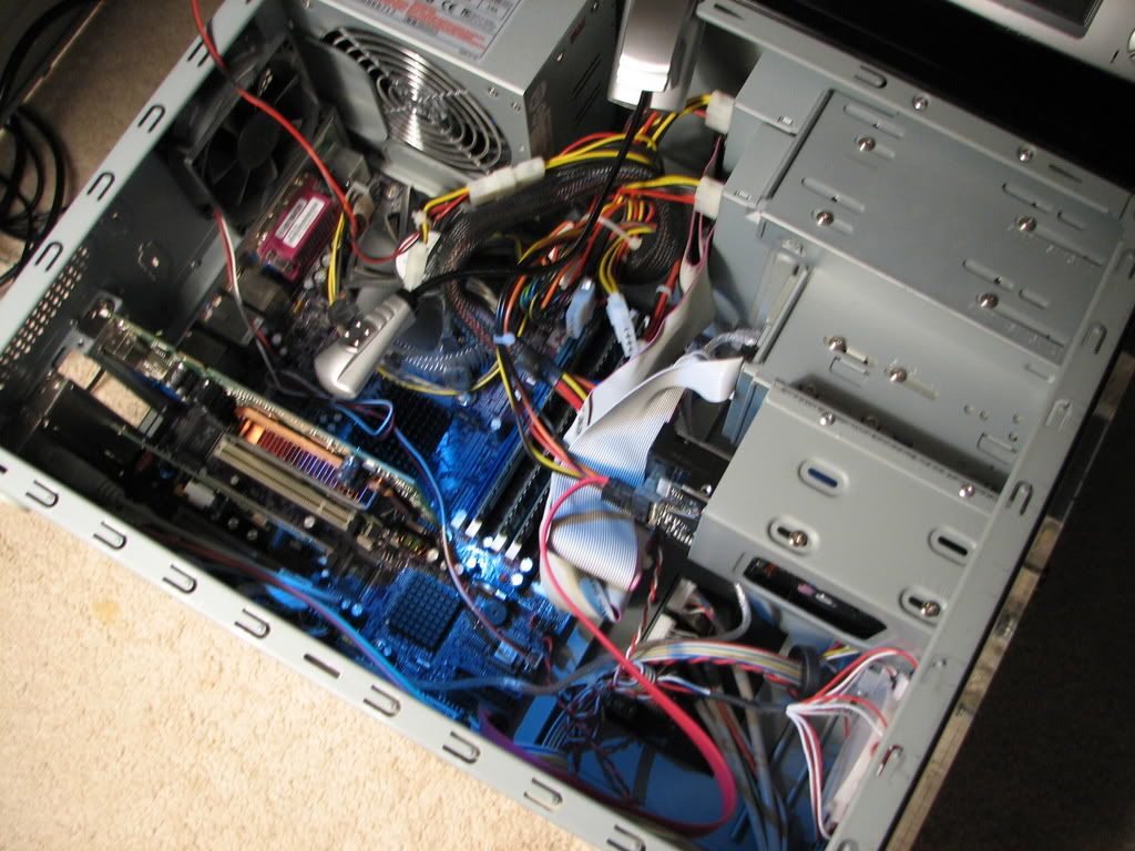

I'm not sure if I'm looking at it or not. Ive taken a few pictures to help.
I don't have the knowledge myself on how to short it, if that is whats wrong with it, so I'd probably get some help. The main thing though is that after some one else looked at it, they figured that part of the power supply shorted out, considering the front of it doesn't glow blue any more, and its not getting anything on the monitor. Is it true that it may have broken part of the power supply, and if shorting it doesn't work, to get a new one?
Circled in red what I think is the battery, and what the jumpers may be.

The part the light is shining on is the area where the battery + jumper is (Lower right)

smell ur powersupply, if it smells odd, kinda like idk burnt plastic? then its burnt, and is junk, and then look at your ram slots for any melted plastic, i would also recommend switching to your old video card and ram while doing this, then if the psu doesnt smell and no burnt spots, try running again
ive burned quite a few powersupplies, and a few motherboards cause of various reasons in my day, and your motherboard doesnt seem to be burnt, however the ide cables in the way so i cant get a good look from the pic
the PSU doesnt smell burnt, and I've already tried using the integrated graphics and my old ati card, no luck. No melted plastic either. I tried running again, but the front still isnt glowing, besides from a yellow light thats on for a few seconds during boot.

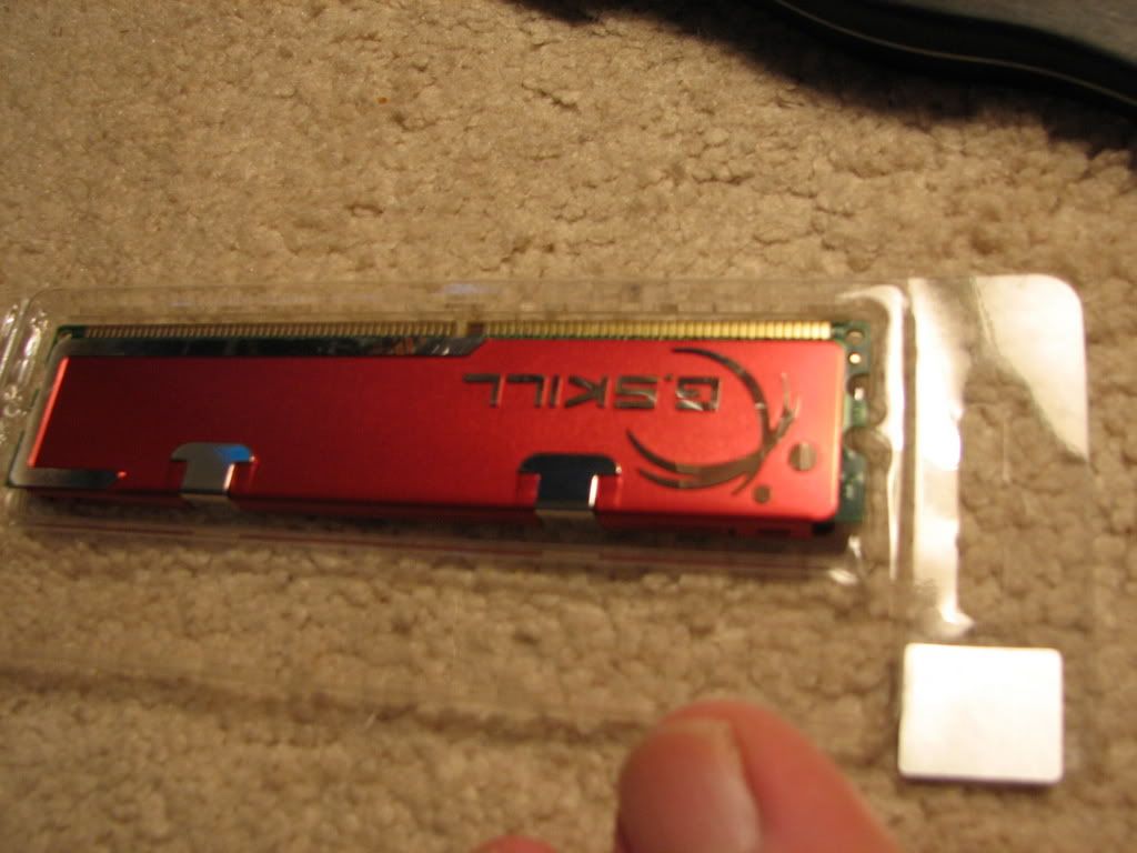

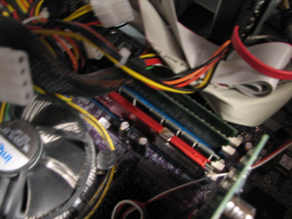

Thinking about it. the ram stick itself didn't have a clear 'forward' direction. Maybe I put it in backwards, thought I assumed the front of it to be the part with the labels.
Edit: I did happen to get a picture of the way I inserted it before it fried. The side here: http://i67.photobucket.com/albums/h299/ttpmurphy/IMG_3388.jpg
is what I assumed to be the front of it.
So I installed it with that side facing the way the rest of the sticks were.
http://i67.photobucket.com/albums/h299/ttpmurphy/IMG_3391.jpg
