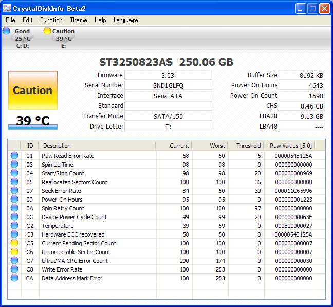

Hmm, very odd. I wouldn't suspect a graphics card being the issue with a constant rebooting issue. I would be suspect of ram or hard drive. CrystalDisk Info is a good tool to see how your hard drives are doing. Also for memory I would use memtest and check that out.
