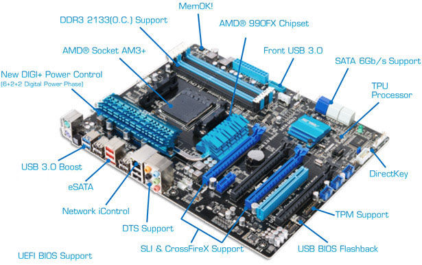

if you have properly inserted you Ram sticks in memory slots properly and firmly then let it be there. Coming to BIOS update, the latest version out there on Asus website is 2201. After you have downloaded the compressed file from website, extract it using WinRar. Now open the extracted folder and you will see M5A99FX-PRO-R20-ASUS-2201.CAP file inside. Rename that file to M5A99FX.CAP. Get a flash storage and format it with FAT32 under File System. Then shut down your pc(Don't switch off from wall socket or psu). Insert the flash drive in Red indicated USB port of your motherboard. Press the BIOS FL_BK button as stated in pic below for 3-5 seconds and you can see flashing light.
When the light goes out completely, your bios is updated and take out flash drive and then turn your pc on.
