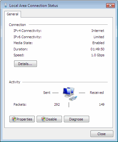

Please provide a screen shot of your ethernet status at the very least. It should look like this:
https://uit.stanford.edu/sites/default/files/images/2010/01/11/vista_e06.gif
