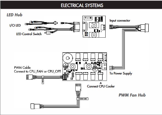

  • - NZXT H440 (new edition / 2015) case which includes a fan hub on the back of the case, it has 4 fans included (one on the back and 3 in front) which all are 3 PIN (!!!) fans

that kind of hub is intended to power a group of fans off 1 psu cable, with no control. you can power the hub from a mobo header if you dont overload it. a little googling found this similar post that i think already has all the answers you could want.
http://www.tomshardware.com/answers/id-2851219/plug-h440-fan-hub.html
in short, the hub allows all the fans connected to it to be powered from 1 source, and will all be controlled together if that source is a pwm header.
the concern is overloading the maximum draw to the header. though your included fans should be fine. read the post, they explain it all nice and clear. of note is the 3rd party hub meant specifically to give you pwm control over the fans grouped to the hub...
The PWM fan hub you're speaking of only has two 4 pin connectors and the rest are 3 pin connectors
and only one end needs to go your PWM fan header on your motherbaord and the other is the source PWM signal like a CPU fan cooler. You can then have all the other fans in your case hooked up to the remaining headers on the hub.
The fans will all ramp up or die down with respect to the CPU cooler if the PWM hub is connected to the CPU_FAN header on your motherboard.
the concern is overloading the maximum draw to the header. though your included fans should be fine. read the post, they explain it all nice and clear. of note is the 3rd party hub meant specifically to give you pwm control over the fans grouped to the hub, listed in the last post.
