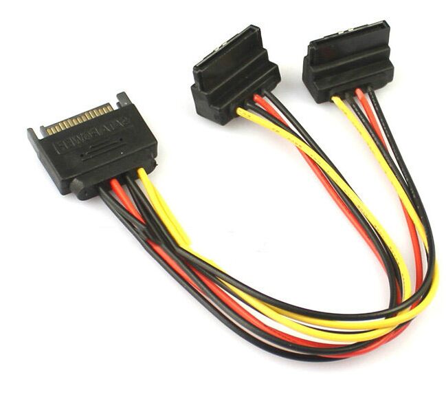

Now with the 9010 YOU CAN add in ANY standard ATX power supply. The only thing is you WILL want to get a 90 Degree adapter for the hard drives as a normal connector won't work. You would need the following.
http://g01.a.alicdn.com/kf/HTB10LZoKXXXXXcoXXXXq6xXFXXXJ/2pcs-lot-hot-font-b-SATA-b-font-15-Pin-Male-to-2-font-b-SATA.jpg
