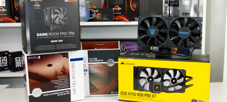

Reading more about threadripper cooling, it is not only the coverage of the surfaace area that matters, but also the arrangement of the particular cooling areas.
Here is andinteresting review of several cooling solutions.
Surprisingly, it is the noctua NH-U14s-tr4sp3 version that shows up well.
The cooler is 165mm tall and will mount in the meshify C case which allows 172mm.

Yes just purchased the NH-U14S-TR4SP3. Designed for use with TR. I watched the videos above and read reviews on Amazon. I saw a lot of positives especially with the 3970x
