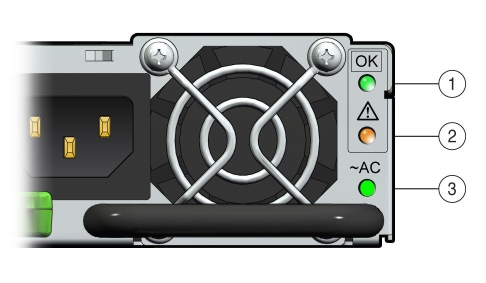

Want to ask something to johnnyguru (maybe he's monitoring this thread). Have PSU manufacturers ever thought about adding a USB interface and/or LED status panel to PSUs, could show stuff like;
  • Temp
  • # Faults detected in past 5 (n minutes) - if the machine rebooted a small light could even flash....
They wouldn't even need to put a panel, a simple usb connection and a driver to read the data.
Oracle Server PSU for reference.
Ok, admins can now slap me for hijacking this thread......

They have and it's available on some more high end models.
