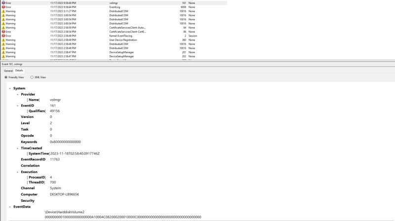

Thank you for the quick reply! I just grabbed Faceit about 3 days ago so I know it isn't that piece of software. I will definitely try this method and post back here with the DMP files.
Update: I played league today testing it out and didn't encounter any crashes while playing. I did notice the performance decrease however when playing.
I did disable the drive verifier for a game and had an application crash (not a full windows crash so no minidump was generated) in the first 3 minutes of the game. The 8 hours prior I had no issues with the verifier running, other than performance loss in game.
8 hours of Driver Verifier isn't long enough. I asked for 48 hours for a reason. Driver Verifier can only check drivers that are loaded, so you must run it long enough to have loaded every third-party driver, so run every app and use every device.
For clarity I had every program open to mimic the same setting as when I crash. I even was running the FaceIT application. I realize it wasn't 48 hours just wanted to post that it crashed as soon as I turned off verifier and ran fine when it was on (at least for the 8 hours).
I did turn verifier back on and boot up FaceIT Anticheat and league at the same time which did cause an instantaneous crash twice. I will say I was having these crashes before installing and running the FaceIT Anticheat. I only downloaded and ran the FaceIT anti cheat about 3 days ago 11/08/2023, since posting this I have uninstalled the FaceIT application to remove it from the equation. This issue with league crashing has been an ongoing issue since I purchased my PC back in 2022.
Posting some dump files below:
Am I able to cycle the verifier off when I actually want to play a different game besides League? Or do I need to keep it running constantly for 48 hours straight.
If you want Driver Verifier to stand the best chance of finding a flaky driver you MUST keep it running.
FWIW both of the dumps you just uploaded Driver Verifier detected BSODs caused by FACEIT_AC.sys illegally referencing a user handle. This version of FaceIt needs to be uninstalled. Permanently.
I uninstalled it after I posted those dump files. For my own knowledge what does it mean they were referencing a user handle.
I do want to add that while verifier runs my league of legends is completely stable and hasn't crashed a single time. When I cycled it off that one time the game did crash immediately every game after, sometimes multiples times. Not sure if this even helps but wanted to add this just in case. The game also goes into a "suspended" state in task manager.
In kernel mode, drivers should only reference kernel-mode structures. By attempting to reference a user-mode handle (a link to a file) the driver caused the BSOD. It's likely just bad driver coding.
I've seen that before (working with Driver Verfier enabled but BSODing with it off). I suspect that this probably indicates a hardware issue, the extra delay in the driver caused by Driver Verifier is enough to allow the device to respond properly. But that's just a (plausible) theory.

Hey quick update, I did get a unexpected restart today. This was during low workload, I had no games open only Discord and spotify. Could this possibly be caused by RAM that isn't on my MB QVL list? The second list points to something called HarddiskVolume2. Could this possibly be one of my SSDs?
It's not really possible to make any determination based on those two images. Upload the logs themselves if you like and I'll take a look....
