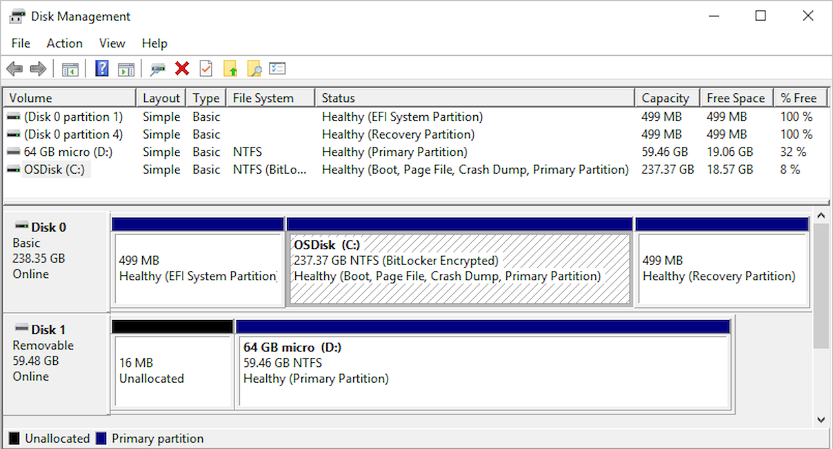

Can you show screenshot from Disk Management on your pc with all original drives connected?
(upload to imgur.com and post link)
I'd suspect HDD with win7 has bootloader on it. Without this drive your pc is unbootable.
And win10 drive doesn't have a separate bootloader on it.

How can I check where the bootloader is actually located?
Bootloader usually is a small partition - either
primary, active (has word "System" in description) on MBR drive or​
EFI System on GPT drive.​
Quite easy to spot it, when observing Disk Management screenshot.
Here some examples:
Bootloader in EFI System partition:
Bootloader in Primary Active partition:

I took out the SSD and connected it by external USB enclosure so that it would show up in the Disk Management. It is listed as Disk 2. Here is the screenshot:
It seems that both disks - HDD with Windows7 and SSD - have the bootloaders. Or am I getting something wrong? There is "System, Active" partition on HDD and "EFI System Partition" on SSD.
Windows 7 disk has legacy bootloader on it (Primary, Active, System partition).
Windows 10 disk has UEFI bootloader on it.
