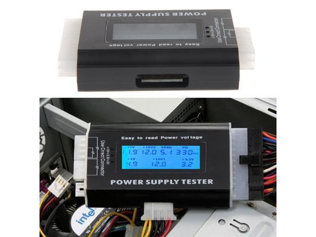

We also have one digital LCD tester as shown below.
