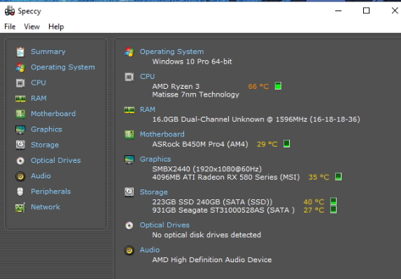

My Son's Monitor randomly shuts off when performing simple benchmark test
https://gpu.userbenchmark.com/Software
I'm thinking it's the Power Supply - is there a way to verify this or i have to actually install a different (w/more Wattage)
Can someone give me a link for a Power Supply at Amazon.ca , hopefully not to expensive and will just be enough power to not cause problem
OR maybe temp related - since I bought it 2nd hand and it's custom built
PC Spec:
CPU: AMD Ryzen 3 3300X 4-Core Processor
CPU Cooler: DeepCool GAMMAXX 400 V2 (Red)
Motherboard: ASRock B450M Pro4
Memory: Corsair Vengeance DDR4 16GB 3200MHz (2 x 8GB)
Storage: 240GB SSD; 1TB HDD GPU: MSI Radeon RX 580 4GB
Case: DeepCool MATREXX 55
Power: 500W
Fans: upHere (from Amazon)
[url=https://postimages.org/][/URL]
