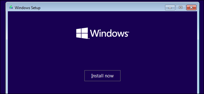

And then follow my guide when you are ready to go IF you decide to do a clean install, which is advisable but not mandatory if you don't build a new system. If you do, you need to do a clean install if you want to avoid issues.
