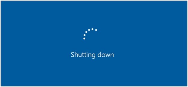

From day to another I heard at night my pc starting itself, i turned it off, then after 30 minutes it started itself again, so I turned off the extension cord. I used to put it in sleep mode a lot. In June sometimes it woke up from sleep mode, after I shut it down every time and unchecked all peripherial permissions to wake it up. It seemed okay until yesterday/today.
In the morning it turned on by itself, after 3 minutes it turned of without saying anything. (It's important, that every time I was logged in it never went just black, it showed the shutting
down screen
It turned it on and off a couple times, once after just typing my pin when logging in and a couple times when it did not even load windows.
There is no fast boot, no oc. I checked if any peripherials have the permission to wake the computer up.
Started to run some diagnostic software but it turned off itself during that.
Tried powercfg -lastwake and powercfg -devicequery wake_armed (<-- this said NONE).
I have not downloaded anything yesterday, just turned off my sql server which has nothing to do with it.
Could not check any driver issues because it shuts down... o_O

These may caused the problem, but how should I solve it?
I was thinking about the psu, but if it caused the problem the system would just go black, not shutting down (I think).
