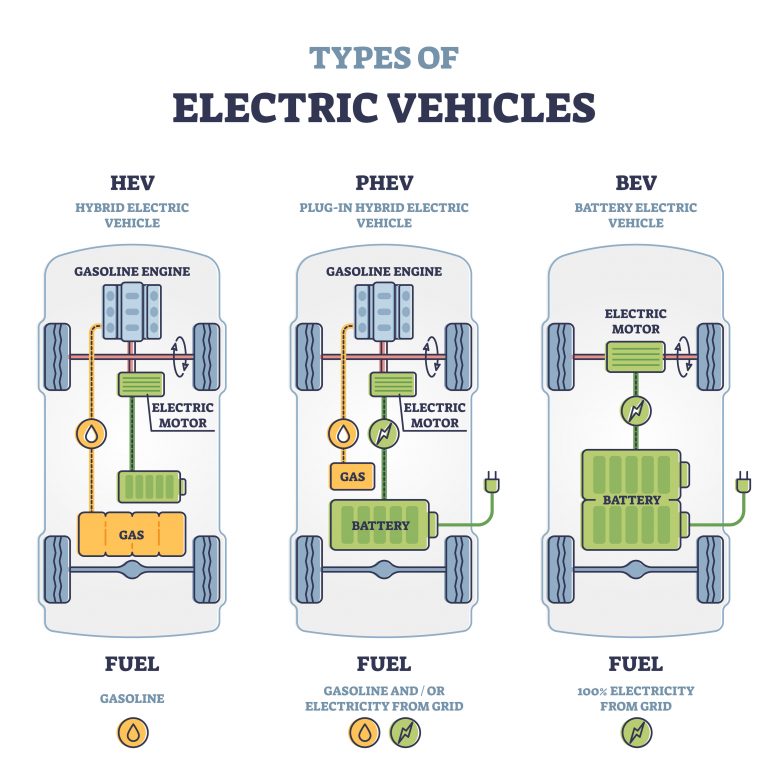

like a hybrid electric car does
HEV generates electricity solely due to gasoline engine it has. Whereby gasoline engine then rotates the shaft inside the electric motor to generate electricity and some of it is stored in a battery. For a HEV, it's driving range using solely electricity is very small. 20km or so (due to small battery). Without gasoline engine, HEV won't be drive-able (some HEVs use electricity stored in battery to reduce load on gasoline engine, rather than being alternative mode of power to turn the wheels).
