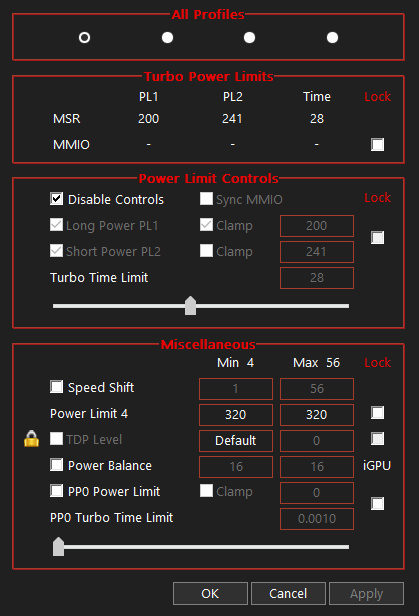

Hello! Hope you're fine.
Last days Windows 10 Enterprise LTSC started to feel laggy and with really bad performance while using the explorer and gaming. When I monitor the CPU usage at idle seems fine, but when i move the mouse or load the pc it gets stuck al cores at x40 3900mhz . Temperatures are way more than fine, all below 50°. Here are some specs and images:
Hope you can help me. Thanks in advanced.
@gdrick
Your ThrottleStop screenshots look OK. HWiNFO shows a warning beside the 3 GB/s interface.
Check the Log File box on the main ThrottleStop screen and play a game for 15 minutes. When finished testing exit the game and then exit ThrottleStop so it can finalize your log file. Copy and paste the log file data to www.pastebin.com
One of your hard drives might be failing. Try running CrystalDiskMark. Check the speed and health of your drives.

Thanks for your answer. Here is the pastebin:
The game seemed to work fine but it lagged heavily when moving the mouse. The process that seems to perform the worst is the windows file explorer. The disk with the exclamation doesn't seem to be the problem as it is removable and no changes without it.
The log file shows your CPU running at full speed with no throttling issues.
