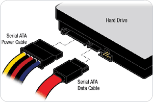

From that link you gave the hdd looks like this. Sata power and data on the left (Holding the drive the same way as picture) and 8 pin on the right for jumpers. Example on jumpers further down this post.
Or do you have a hdd like this? With molex (left) power and also sata power to the right.
Picture of Sata power and data cable...

Your psu has sata power, think maybe youre getting the cables mixed up.
main-qimg-8cde9b130bbdc0c8118df2e92f216b7d
Picture of grey jumper. These days don't need to use jumpers to configure master/slave
Hope this helps.
