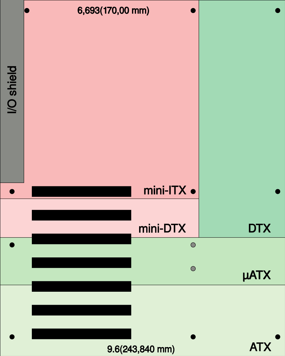

From everything I've gathered about your computer it's a standard itx mobo. Can you look and see if you can see a model name on the move someplace?
I’m sorry for the delay in the answer but I couldn’t do it before than now. So I checked and from my measurements it seems to me that this mobo (MS-B9181) is not a mini-ITX. It seems that the lengths are assimilable to a mini-DTX (203x170cm) mobo but I’m not even sure because I wasn’t able to pull out the motherboard as I can’t figure out how to disassembly the CPU cooling system (which is ad-hoc for this build). So I think I will get the Enhance FlexATX 600W because the price of a mini-DTX case plus the price of a new SFX PSU and the one of a new cooler for the CPU is higher than the price of that Flex PSU. You have also to consider that, although I’m a tech lover, I’ve not high practical skills as this is the first desktop PC that I have ever owned (just laptops in the past) and during the switch from a case to another the probability that I’ll screw it up is high lol. This is the only option I suppose.

DTX/mini-DTX ought to fit in pretty much any micro ATX case. It's meant as an ATX variant.
rison_atx_194181atx_dtx_itx_mini-dtx-jpg.124480
Wow, that tight case looks like a nightmare, but as DSzymborski said, you should be able to fit it in a proper normal case if you wanted to.
