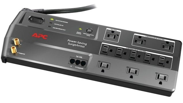

For that power bar to do anything, your 230 VAC must increase to well over 500 volts. How often is your voltage increasing that much. His APC power strip ignores any voltage at or below 330 volts. Why did he ignore the numbers in its box? Because most electrical recommendations come from myths in advertising. He has no idea what your coil whine is. But he has been ordered by advertising to always recommend those ineffective devices.
