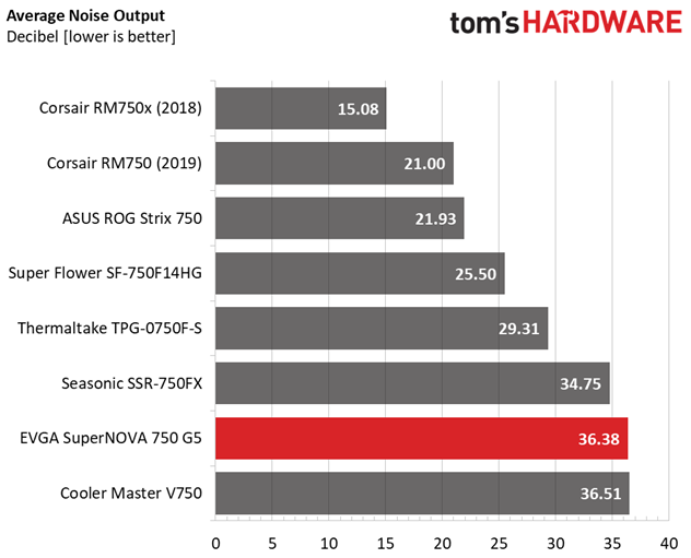

Apparently, the G5 series are loud. Here's an excerpt from a review of the 750 G5 done here at Tom's. The G3 uses the same platform as the Superflower model listed to give some reference of how much quieter it is. The Corsair RMx series kills all with quietness. You should read the entire review of the G5. Too bad you didn't see it before you purchased. They're not really recommending it. If the fan noise is something recent with yours you should return it, but, if it's been that way since you installed it, now you know why.
Noise Rating
The graph below depicts the cooling fan's average noise over the PSU's operating range, with an ambient temperature between 30 to 32 degrees Celsius (86 to 89.6 degrees Fahrenheit).
This is a noisy power supply, so if you cannot stand loud PC parts, better stay away from it.
