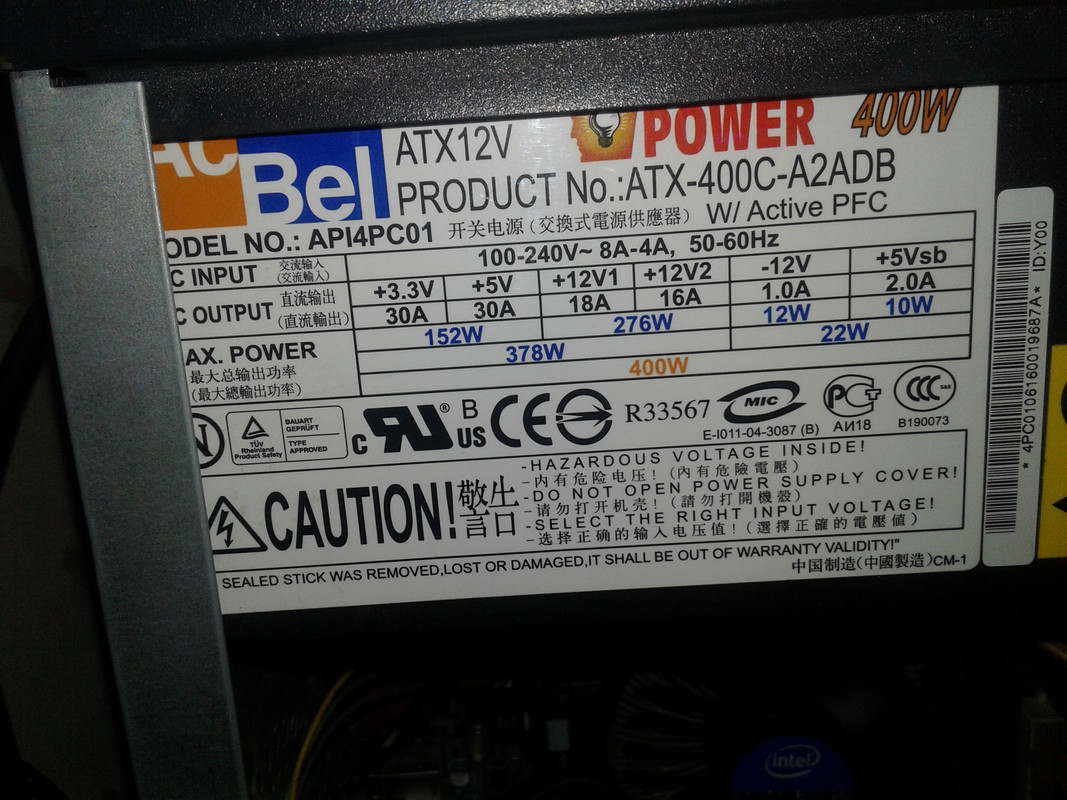

Hey guys, I have some issues with this AcBel PSU I have. as I said here, some games (Like Half-life 2 and Mafia 2) cause the PC to set the Fan Speed to Max and the Screen appears Black until I shut it down and reboot the PC. I found out underclocking the GPU can solve the Problem but in cost of 20-30 FPS which is terrible.
After some research, I found out that this Garbage AcBel PSU I have is causing the Problem. So I found a good quality cheap available PSU (I saw these are working for 10-11 years without being unstable + long guaranty + Cheap Price).
MY CURRENT TRASH PSU

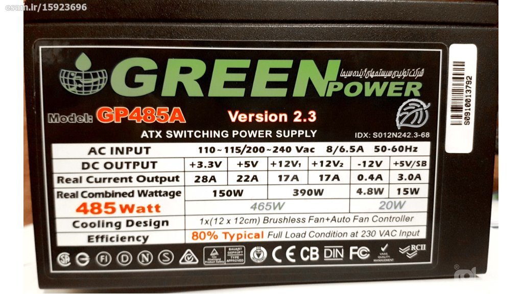

PSU I'M BUYING

So I have this Question, Can I stabilize my Gaming by Upgrading my Trash AcBel to this Good "Green" PSU? (Which works for 10-11 years with being stable)

Both are junk power supplies... really. The +12V power output is not everything... voltage regulation, ripple, quality of the components matter more.
I've come across a lot of Dell OEM 180W 80+ Gold Delta made PSU that I'd take everyday over that green "485W" junk.
AcBel also provides PSUs for Dell prebuilts... though their units are much lower quality compared to Delta. On the other hand I've never heard of a Green PSU until now.
I'll refuse to recommend any of those 2 you posted... they're outright dangerous only looking at the label.
As @Lutfij pointed out, provide us with a store from your country and a budget.... maybe we can recommend something that won't set your house on fire, atleast.

Wow talk about going from bad to worse.
Neither of those are fit to be a doorstop let alone a PSU. As mentioned above any chance you can access any of those brands?

Nope. I either have the Choice of the "Green" PSU (it's a well-known brand in Iran) or the CM MasterWatt Lite one.
