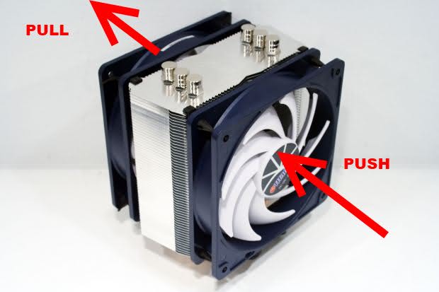

Pull would be having your fans positioned so they are pulling air through the radiator.
Push would be positioning the fans so they are pushing air into the radiator.
Push and Pull is having both at the same time. On one side of the radiator a fan pushing air into it, and on the other a fan pulling air out, they are both moving the air in the same direction through the radiator.
