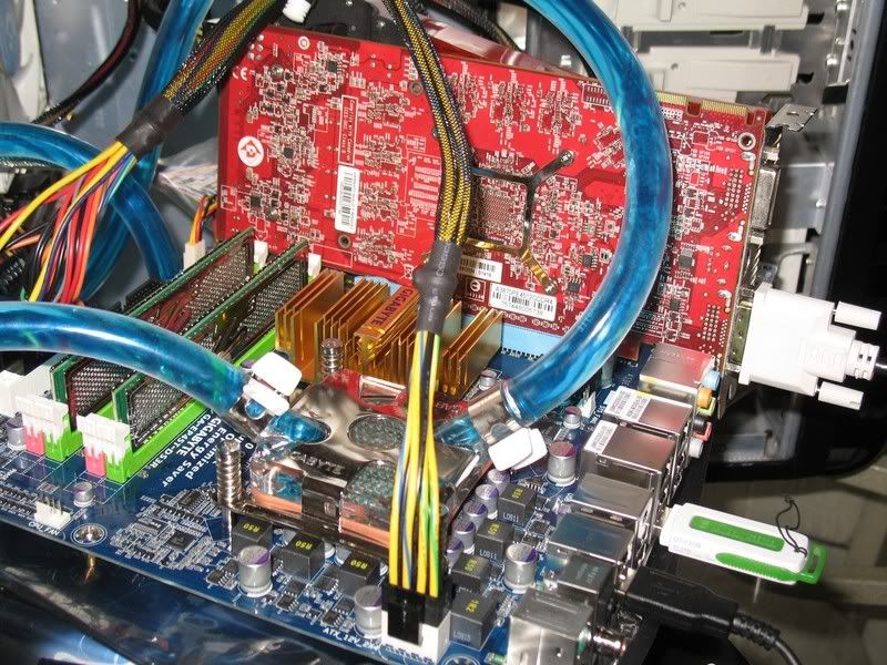

I have a Q9450 and I have a gigabyte galaxy II water cooling system running. I just got my system stable last night because it had a bad display driver and i had used coretemp and it showed that each core was around 50c.... i thought this weird because minutes before I'd been in bios and my pc health section had my cpu @ 15-20c
Last night I got realtemp and it showed the cores at around 37-40c avg which i still think is hot for stock settings...
i really don't want to rma the cpu if this is just a known issue w\ the sensors.
http://i43.photobucket.com/albums/e383/bbaucom/b.jpg
