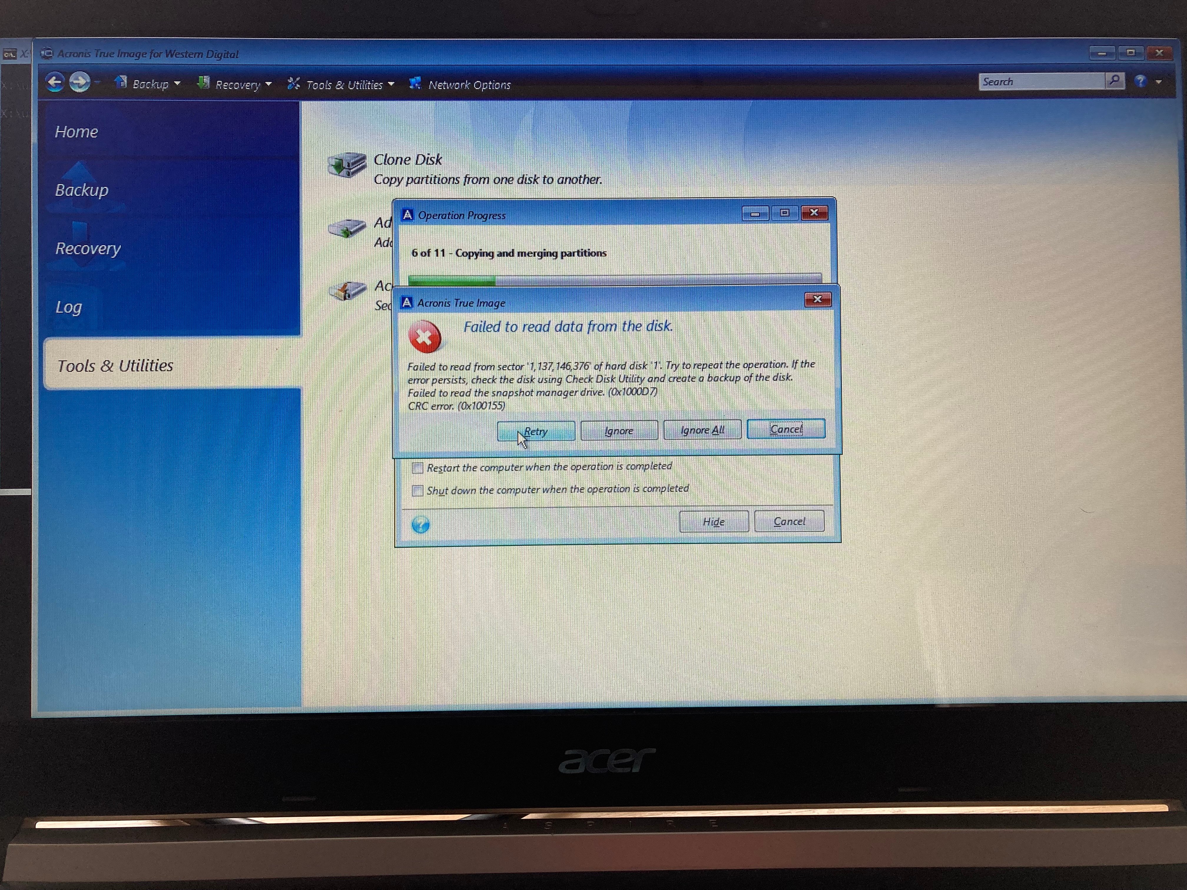

I tried to clone with Macrium first but it failed with "Cyclic Redundancy Check" error for the 7th partition, in Ubuntu Disk report there was just 1 bad sector on the HDD.
While cloning my dual boot Win+Ubuntu HDD using WD's version Acronis True Image to the SSD I got some CRC errors too but the process completed successfully. I used the Bootable image for both Macrium and Acronis to clone the HDD offline.
Win 10 booted without issues but had a minor hiccup with the Ubuntu (only the GRUB shell will show).
So checked some forums and used Ubuntu Boot-Info tool which showed the issue was during cloning GRUB was installed in partition1 instead of partition7 where my Ubuntu installation was
So used Ubuntu Boot-Repair tool which reinstalled GRUB in the correct partition and voila! 😎 My Ubuntu was back in business and Grub loaded working as before 🕺
