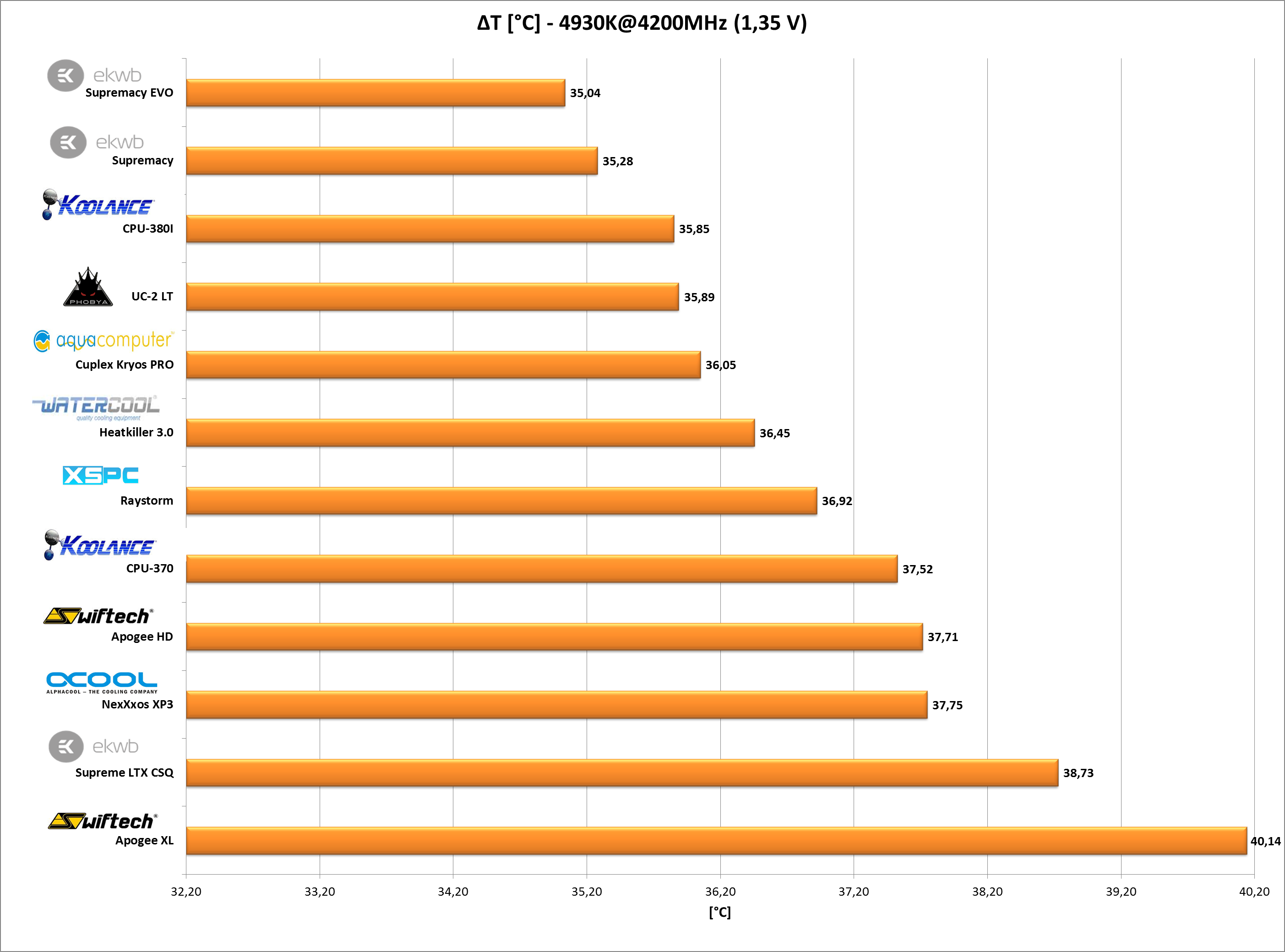

As for the "Who is king of CPU Water Block Cooling"
EK for the win on Haswell
2150326
EK for the win on IB-E
LL
On GPUs
EK is 1.6C Hotter than the leader (XSPC) on the GPU
EK is 3.2C cooler than the next best manufacturer and 6C better than XSPC on VRAM, 10C better than EVGA
EK is 12C cooler than the next best manufacturer (XSPC) on VRAM, and 30C better than EVGA
- 1.6 + 3.2 + 12C puts the EK at 13.6C better combined temps than runner up XSPC.

For CPU Water Block the most extensive stuff can be found on xtremeystems site and also on OCN. The GPU WB stiff comes from xtremerigs
CPU Latest Stuff - http://www.overclock.net/t/1505481/summer-water-block-round-up-2014
CPU Older stuff - http://www.xtremesystems.org/forums/showthread.php?285753-CPU-water-blocks-roundup
GPU - http://www.xtremerigs.net/2013/10/03/nvidia-gtx780titan-water-block-roundup/
