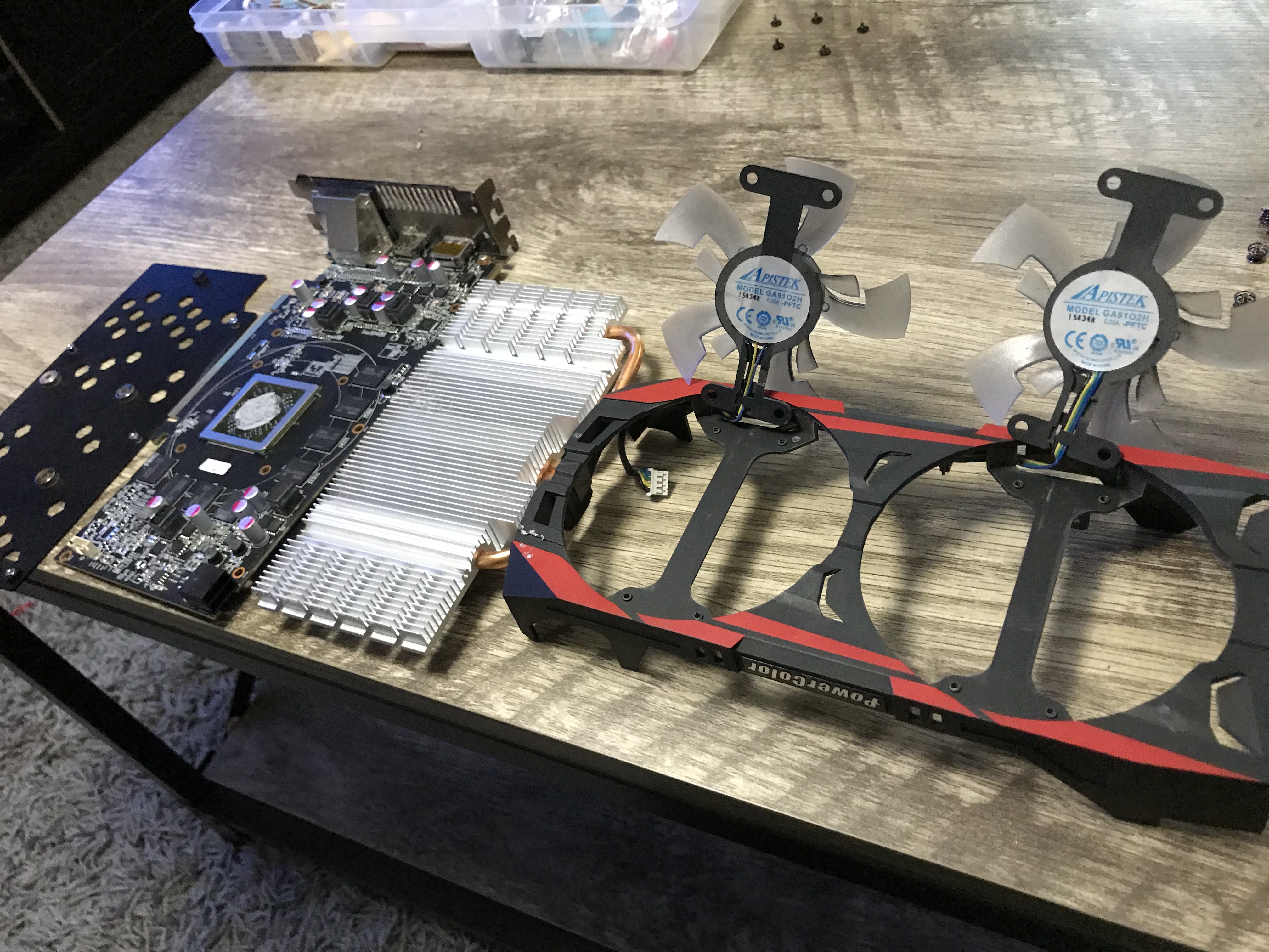

I opened up my PowerColor R9 270 that has been not working properly. Fans stop spinning when PC boots up to desktop page. Fans only turn on using MSI Burner, but nowadays MSI Burner doesn’t do the trick anymore.
Well, this is my first time opened up a GPU, but I noticed some of the screws loosened and there were no manufacture void warranty sticker so I assumed this GPU were used?
Does GPU screws become loose over time?
The thermal paste is very dried and I do plan to redo the paste and insert some thermal pads on the vram modules to see if that will fix the fan issue....probably not I think.
I put an “X” on one of the photo because I’ve located some other people’s similar GPU and theirs have a thermal pad on that specific location. So I am wondering if mine was super used and was opened and not taken care of?
I can't see any reason there would be a thermal pad OR paste in that location. I'd just repaste and reinstall the cooler exactly as you know it should be, and not worry about what other cards might have unless you can find a concrete reason for having a thermal pad there. There might be a reason, but it would likely be an aftermarket modification. That doesn't look like there's ever been anything there AND there are no components in that location that seem as though there ought to be a pad there.

Only thing that would fall under there are the ram chips. Cooling them certainly wasn't a priority in this design and probably unnecessary.

The Ram chips are the ones it looks like you are talking about that aren't covered by a thermal pad or something like that.
