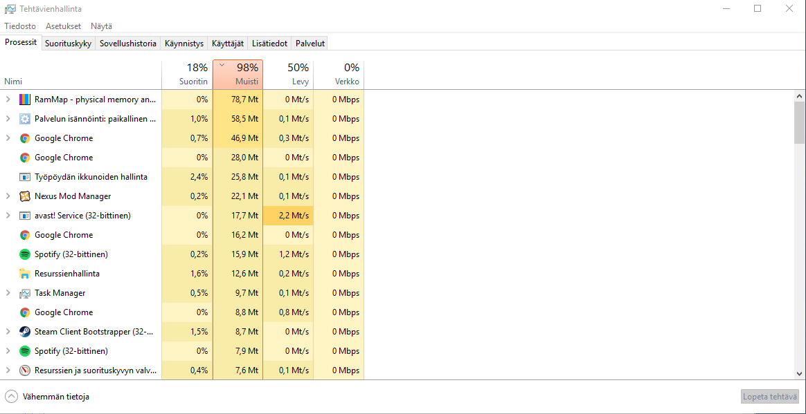

From task manager under processes tab:
https://i.gyazo.com/5485e576e1a0ab9db562a67a5d1e401e.png
The highest was taking only 78 Mb which is far away from 8Gb

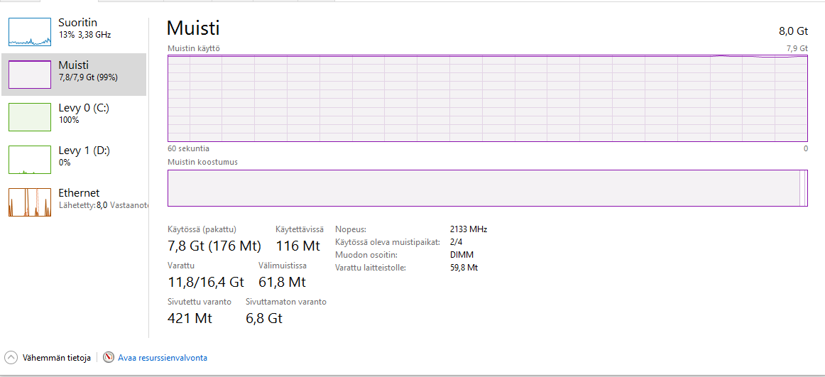

From task manager under performance tab:
https://i.gyazo.com/91a7d3f8542a18db37a4eabe5e1a3444.png

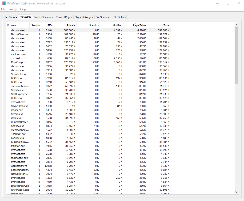

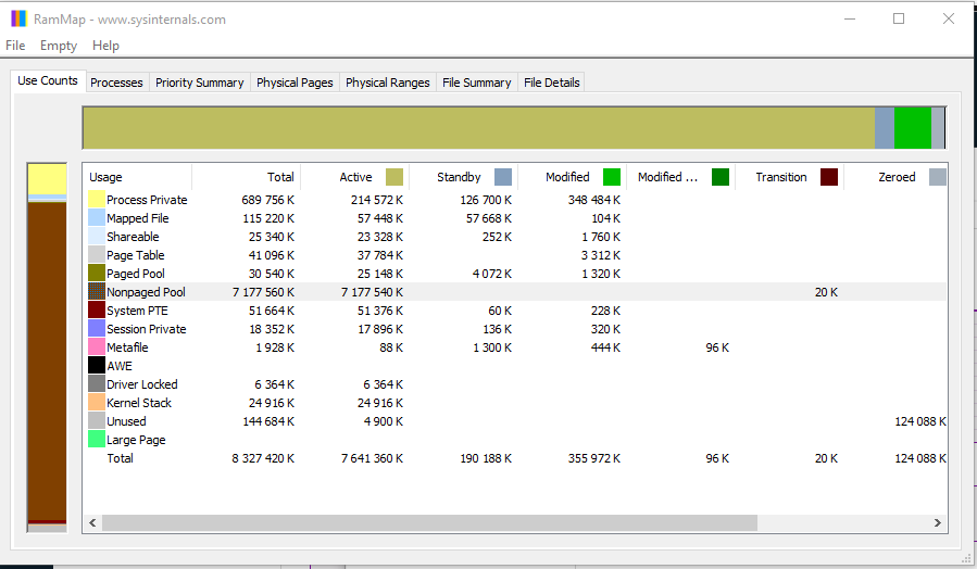

And from RamMap:
https://i.gyazo.com/f89810dbcf5baf4d919b8e9ade5fc4a0.png
