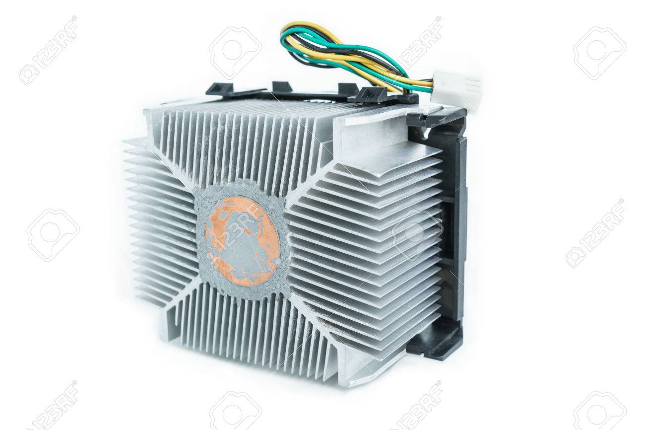

Actually i cleaning my motherboard on yesterday morning., but suddenly i want to replacing my thermal paste., then temperature going worse then the stock applied thermal paste., then i relized my cpu doesnt seems to attached to my motherboard since it was sent by the seller. then i got a new problem cant attach the heatsink properly because of that. cant get the right place of the heatsink to the cpu ( http://previews.123rf.com/images/thanmano/thanmano1503/thanmano150300065/39034329-heat-sink-of-cpu-in-isometric-bottom-view-Stock-Photo.jpg ) see that center of the heatsink in that images? and it was the problem that caused my cpu wont cool down like before it replaced....

Look at the manual for MB, there should be 2 plastic parts at the places where those holes on MB are. That's where CPU cooler is supposed to sit and attach with clips to. Besides that, paste is splatter all over and way too much of it too.
If I was you, I would look for a good aftermarket cooler. That setup is highly bastardized !
