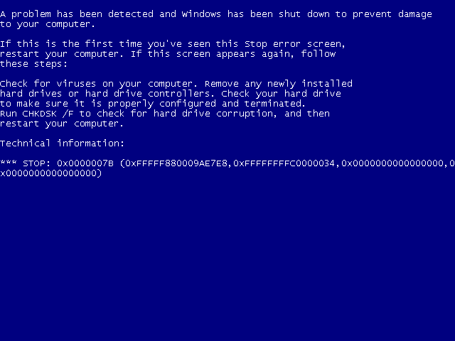

e) A blue error screen flashes for about a tenth of a second. To see it I have to take a video with my smartphone and then play it back in slow motion and then freeze it.
A problem has been detected and Windows has been shut down to prevent damage to your computer.
*** STOP: 0x0000007B (0xFFFFF880009A97E8, 0x0000000000000000, 0x0000000000000000)
This error is because of
SATA controller mode in BIOS incompatible with windows settings.
Possible sata controllers settings - AHCI, IDE, RAID. You have to restore this setting to values were before motherboard change.

I successfully replaced the motherboard, but I still cannot successfully boot into Windows. The error now is different, of course.
Laptops usually do not accept any different model motherboards. Replacement should be identical to old motherboard.
So only difference between old and new could be BIOS settings, BIOS version and board identification.
Please post photo of error, you're getting. Most likely just some BIOS settings need to be corrected for it to work again.
(upload to imgur.com and post link)

OK, once again, I am WELL AWARE of the importance of backing up data and I am WELL AWARE of the large variety of sudden and unfortunate circumstances which would render those backups necessary. The message is received loud and clear, thank you.
What is NOT clear are the answers to my questions, and now I have a tiny bit more information.
1. I have located the Product key for the machine, as it was originally sold (as a refurbished machine). So, if it helps me at all in this particular predicament, I HAVE my Windows Product Key.
2. In response to what error am I now getting, here is what happens when I try to start the computer.
a) Dell Logo
b) Choose an operating system to start (Windows 7 highlighted and is chosen automatically after several seconds)
c) Windows failed to start. A recent hardware or software change might be the cause.
[two options at this point:
. Launch Startup Repair (recommended)
. Start Windows normally
--> If I choose Startup Repair, no problem is found or fixed, so this option isn't fruitful.]
(I choose Start Windows Normally.)
d) Starting Windows...
Highlights from that error screen:
Check for viruses on your computer...Check your hard drive to make sure it is properly configured and terminated...
Technical information:
x0000000000000000)
f) DELL logo and cycle repeats indefinitely until I press and hold power button to shut system down.
UPDATED SUMMARY OF CURRENT SITUATION AND MY QUESTION:
I had a perfectly running Dell Latitude Pavilion E5430 laptop running Windows 7. The motherboard failed, and I replaced it. All other components are working normally, including the HDD. After replacing the motherboard, I cannot boot due the error described just above.
How can I get my system running like before, without impacting my personal data or installed apps? I have no install disk, but I do know my original Windows product key.
If this can be fixed with changes to the BIOS, what are those changes?
If this requires a reinstall of Win7, how do I do that while preserving my existing apps and data?
Thank you in advance for everyone's assistance.
So for SATA controller settings I see four options:
Disabled
ATA (which I assume is equivalent to IDE)
AHCI
RAID
AHCI is checked. By your reasoning the setting must have been one of the other three before the old motherboard failed. So I first changed it to ATA, since I figured that was the most likely.
The same problem occurred (at least it looks like the same). It took me to Startup Repair, where it grinded away for awhile before saying it was done and to hit Finish to try again. I did, and it still failed yet again and now it's doing another Startup Repair cycle. If that doesn't work I'll try it again with Disabled, and then (if necessary), RAID.
I'll let you know how it works out. Thanks!

Disabled setting means - sata controller is disabled and sata ports unusable.
This will disable all your sata devices.
Right you are! I just found that out.
But guess what? RAID.......w o r k e d !!!!!
F2 on startup to change settings.
SATA controller changed to RAID.
Apply changes, --> restart.
Windows boots!
