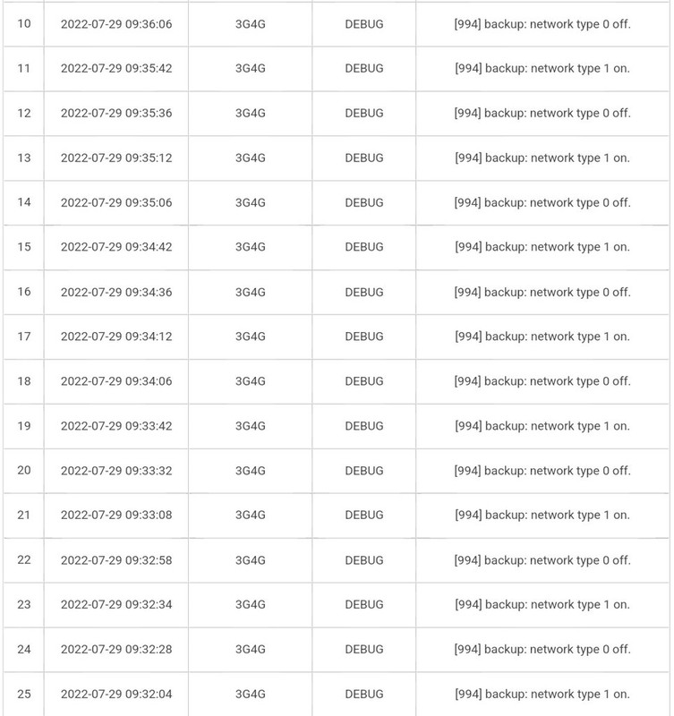

I also started noticing once in a while disconnections on my smartphone from my router in mixed mode. I have checked the log but can only see one message repeating:
