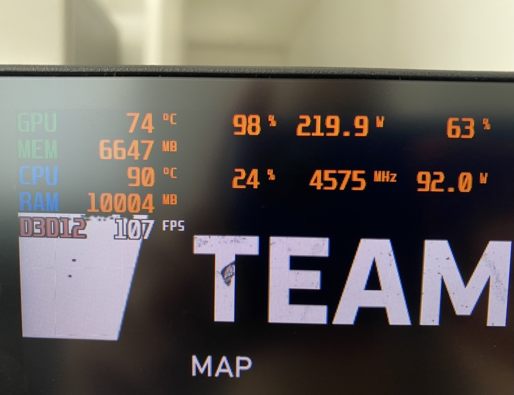

The problem is I am getting so many temperature spikes! It idles at 40-50c, and stays at 74-78 when gaming most of the time, but suddenly I get temperature spikes up to 84-87C, out of nowhere. This happens specially in game menus or when entering/ leaving a game.

Although this can be considered as normal by many, I would like to lower the temperatures, it doesn’t make sense to me that it gets to 87C just by returning to the game menu after a match. I know that many of you have gotten better temps with some CPU tweaks, can you guys help me out with this?
edit: here is a picture of Gears of war 5, where it reached 90C! just after returning to the game menu from an online match.

I don't know what you've been reading, but what you're describing is perfectly normal and expected for Ryzen. The processor uses hot-spot temperature sensors and the temp spikes occur whenever a core boosts clock. It's perfectly normal for the way Ryzen's boost algorithm works.
Your temps are expected and normal too. AMD's said 5800X's are designed to see temps up to 90C before the boost algorithm starts pulling clocks. It's part of the way it works and doesn't affect CPU life span.
