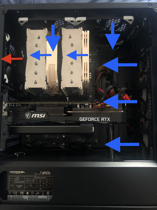

I have very good airflow, let me show you:
Front: Thermaltake case's fans fixed at 1000 rpm (3x120mm).
Top: 2x Noctua Nf-a14 Pwm Chromax.black.swap 140mm
Rear: Noctua Nf-a12x15 Pwm Chromax.black.swap 120mm
CPU: Noctua NH-D15s + Nf-a12x15 Pwm. I used the dot method for the thermal paste NT-H1 that came with the D15s
My room is at 24 C with air conditioner.
I don't know what to change to use this at maximum capacity and get normal high temps (80 C max)...

1)Fans smashed up against a solid panel is always an ouch, even if they are Noctuas. * Looks at V250's front panel
2)The 'folds' on the sides of the NH-D15/S reduce the effectiveness of fans placed up top. This was done on purpose to promote more uniform front to back airflow.
3)Well, having 2 top exhaust would help the gpu more - not so much the NH-D15S, because of point 2.
4)With all that intake, you effectively only have a single exhaust. How hard it must be for the combined heat of that 3080 - which is dumping its heat in the chassis, mind you - and the 5800X to get out of there...
5)Prime95, what? The settings you set do matter. Small FFT, AVX off, AVX2 off, AVX-512 off(Ryzen doesn't support 512 anyway), is the recommended setting for temperature stress testing. Keep in mind, what clocks you see in P95 will be different to games/blender/Cinebench.
6)You already know about Ryzen 5000 boost algorithm, so that's already covered.
That's my 2 cents on the cooling end. Overclocking and the stability issues I'll leave to someone else; I'm not that familiar with Ryzen beyond what I've read.

Probably has nothing to do with this particular problem, but if I ever want to add top fans to my case, I'd put them into the exhaust position. Hot air goes up, so it only makes sense to help it go up. And besides, 5 fans in, 1 out looks like a terrible disbalance to me. I really don't want to start a positive-vs-negative pressure holy war, but whether positive or negative, there gotta be some balance, right? Although with this case, I can't figure out how to achieve positive pressure and have top fans set as exhaust at the same time. But I'd rather go for a balanced setting and make 3 exhaust (rear and top) and 3 intake (front).
ok, I should remove the front panel I think. It has a space on the side but not the best:
and I will try with top fans set as exhaust.

With this top notch hardware you may want to replace the case itself. Because if you just remove the front panel you'll probably end up accumulating dust inside very quickly. My case (Fractal Design Define S2) isn't exactly a gaming one, but it has places for 9 140 mm fans (intake: 3 front, 2 bottom; exhaust: 3 top, 1 rear). I'm only using the stock 3 at the moment, but I'm not really into OC, neither is my hardware that good. I bought it purely for low noise.
My previous case was very old, no dedicated sections for PSU or cables, and to get better cooling and less vibrations I removed both the front and the side panels. But dust management was a nightmare. I had to clean between the plates of the CPU cooler radiator about once every month.
