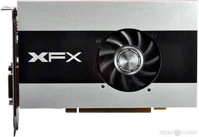

Darn. You are right. I didn't know you had to have a GPU for the 5900X. (Been 5 years since I built a PC and assumed all CPUs come with graphics.)
I pulled out an XFX R7750 GPU from my other currently working PC and put it in.
But, no luck. Same thing happens. Nothing turns on but for the red LED that keeps blinking once a second or so. What does that LED indicate?
Any other ideas?
