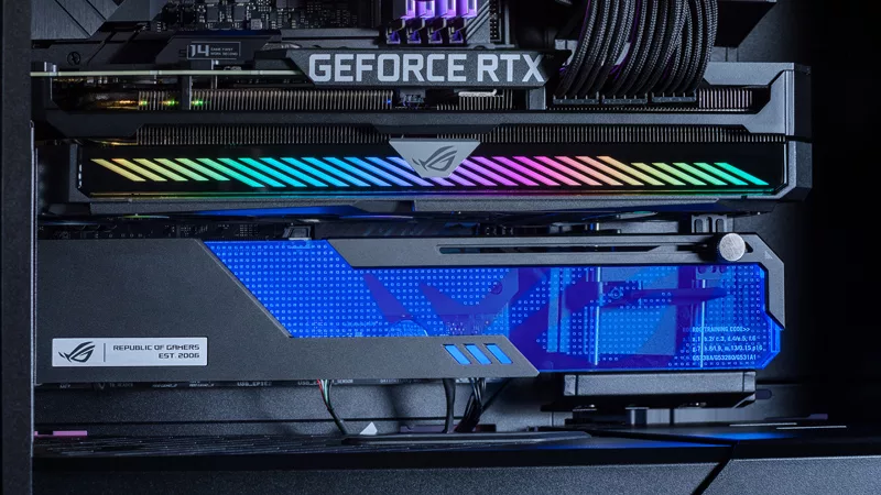

mine has an bracket that runs along the backplate all the way up to where the power cables attach.
Label shows its not an Nvidia card though
