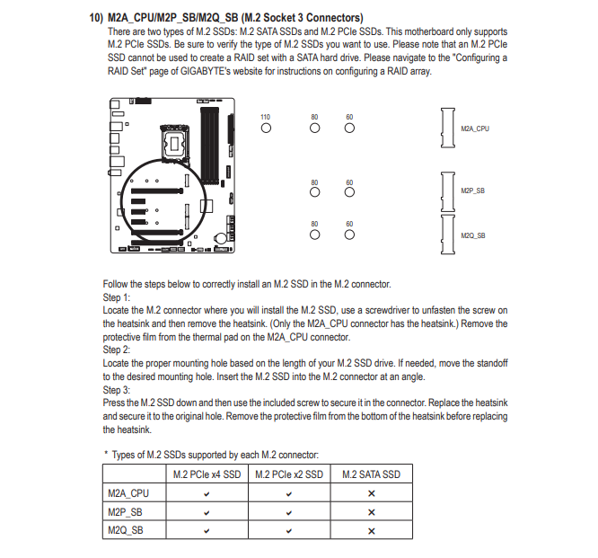

this might make it see it, but it should anyway.
tried all the nvme slots? top one would most likely attached to the CPU
Is it about drivers I need to install ? Or maybe I should install Windows 10 ?
no drivers needed in most cases. I doubt win 10 make any difference.
No, I haven't tried them all. Just the top one (M2A_CPU) like you said. I don't really understand but I plugged it in the wrong slot ?
From the manual:
I downloaded the latest version of the drivers from Intel. But when I browse the folder during Windows installation, there are none that are compatible with the hardware.
EDIT: It was not correctly plugged in 🤓
