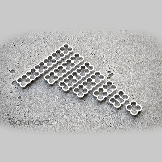

I find round sleeved cables much more difficult to manage, and the reason why many builders sleeve there own cables or use extensions. OTOH, the plain flat cables are just fugly, you can get the best of both worlds with flat, individually sleeved cables. Individually sleveed cables, with cable combs, offer the optimal combination of aesthetic choice and easier cable routing.
