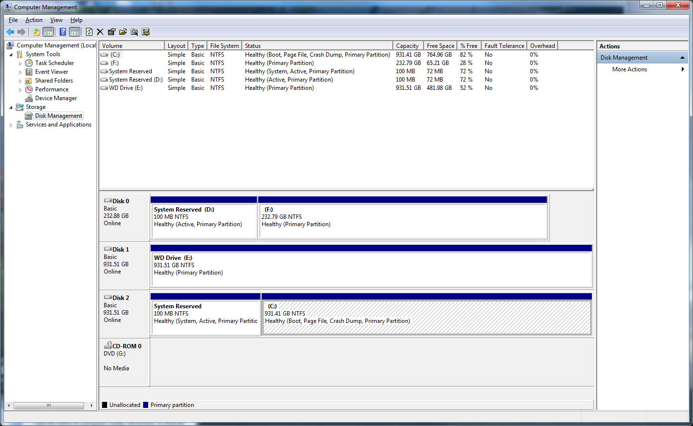

Can you show screenshots from Disk Management,
BIOS - boot priority settings and
BIOS - HDD BBS settings?
(upload to imgur.com and post link)
Here's the Disk Management screenshot. I'll have to do the BIOS tomorrow as it's a bit late and that's a more involved process. (Can't just Alt-Printscreen!)
