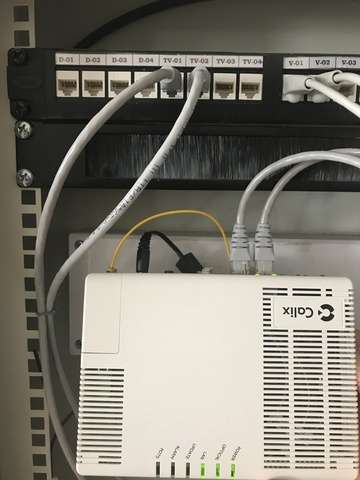

You can see here that the Calix device is plugged into ports TV-01 and TV-02 (which are the corresponding ports that the AirPort Extreme downstairs and the Asus upstairs are plugged into). You can also see it controls two ports for the phoneline as well V01 and V02.
Here is the back of the device

I think you were almost there running AP mode on Asus, but the physical connections necessary are missing. That looks like just a patch panel for room connections rather than a switch. Do rooms have more than one Ethernet outlet?
Right now it looks like you have this:
Modem--->AE(WAN)
Modem--->Asus(WAN)
I believe this needs to happen one way or another:
Modem--->AE(WAN)
AE(LAN)--->Asus(WAN)
If (a) that is indeed a patch panel, and (b) you have more than one outlet in each room, I think you should be able to make this happen by completing the AE-Asus connection with an extra cable at the patch panel.
Also, I used to run AE myself and I recall the setup via the Mac airport utility had a simple and straightforward "Bridge" mode configuration. So making the Asus the primary router may actually be easier. The caveat with that is that I also recall this bridge mode mode did not always work with more modern routers and I don't recall why. Of course my own AE was pretty old too.
Thanks guys, managed to solve it after doing the physical connection suggested by placing the AE next to the Calix box. Then using the AE to provide the connections to the wall sockets and the Asus Router.
