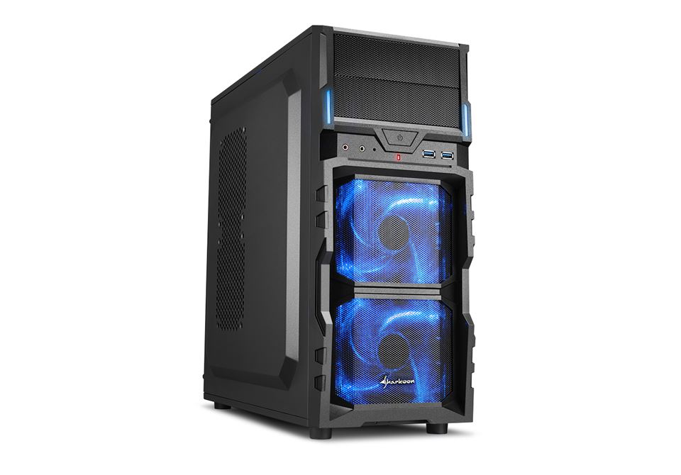

Planning to build a new config, but I have a huge problem:
https://en.sharkoon.com/product//VG5-W#desc this case
and
https://www.asus.com/Motherboards/ROG-STRIX-Z370-G-GAMING/specifications/ this mobo
as far as I can tell not compatible at all.
The Mobo has only 2 4pins fan connectors but the case has already 3 built-int, 120 MM fans. How should I fix that problem? Or simply I should change my case to another one?
